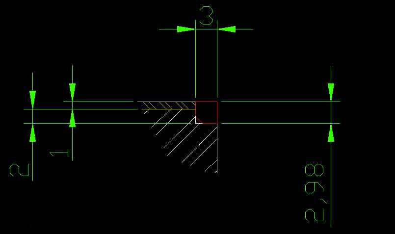

I tried to search but didn't find anything useful regarding to o-ring design or dimensions. My plan is to use copper head gasket and o-rings. Look the cross section pic I made. Does the design or the dimensions look anything right.
http://toyotacover.50megs.com/sekalaiset/Copperheadgasketandoring.jpg
The red part is the o-ring.
Yellow part is the head gasket.
Rest (white) is the block.
The plan is to machine 2mm deep, 3mm wide groove in the block and o-ring will be 2.98mm thick. This 2.98mm is based on assumption that the copper sheet will be 1.00mm thick. Head deck surface will be plain. I can cut the head gasket by laser and I have already made cad drawing of the HG. Once the annealed(correct word?) copper head gasket is assembled it will be compressed 0.02mm and o-rings will seal the combustion chambers. Would this work???
here's the cad drawing of the design. Change it the way you see better!
http://toyotacover.50megs.com/sekalaiset/liekki rengas.dwg
