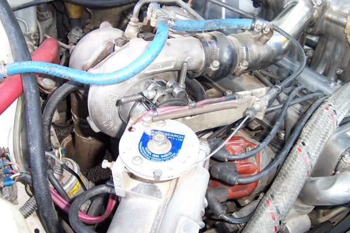

Toyota Corolla KE70 1984
Modifications etc:
Engine: 1G-GTE 2 Litre Twin Cam 24 Valve
Turbo: Hybrid VL commodore with T04 wheels, T04 compressor cover
Deltagate II external wastegate
Gearbox: Alloy supra 5 speed with cast iron sandwich plate
Clutch kit: Toyota clutch plate with RPM pressure plate
Front struts and brakes: RA60 Celica modified adjustable coil overs
Shocks: front Koni adjustable
Tailshaft: modified Corolla with supra front uni and alfa romeo rear uni
Diff: Alfa romeo LSD '71 model 104 Berlina LSD 4.3:1 ratio
Axles: 27 spline
Front seats: Honda Accord late 80's
Exhaust: 3in mandrel bent - 1 resonator and 3in muffler
Distributer: Toyota 5M EFI motor modified shaft with 1G-GTE gear
Methanol injection: 50% water + 50% methanol
