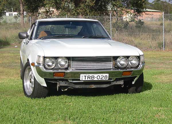

Dude,
The intercooler looks like it should be a great size, Tina's was just that inch or so too big so I had to trim alot of the front headlight and trim brackets
http://www.toymods.org.au/~rod/Celicas/Tina's%2028 /Intercooler%20fitted%20small.jpg
Was just thinking that the show n shine will be the first time I can remember both our cars being at the same place at the same time. Sure they will both be being pushed around lol but will be great to have em both out and about again.
Looks like you will beat me on road tho ya bastard, mine will be struggling for the January Dyno day. Sad
Josh,
The TA22 requires a much smaller cooler than you can fit in an xA23 or xA28. My core is 360mm x 360mm and 75mm thick, it only just clears some of the fittings and the tanks are angled just to clear a few areas. You could possibly go slightly bigger but at the expense of end tank design.
