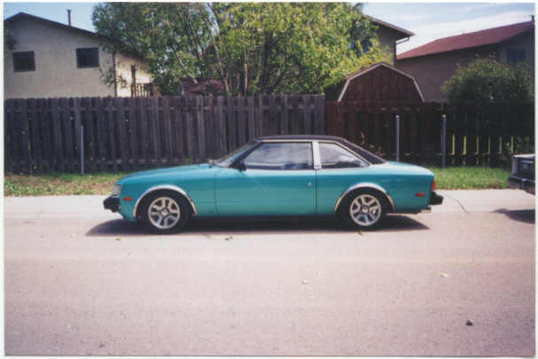

I had an earlier Celica (1981 with 22R) it had a W55(?) if I remember right. Here's a picture of that old car.
http://www.celicas.org/members/tonyleblanc/scan0.j pg
I had a supercharged 22R in that and then I put a 18RG in it.
