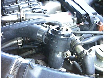

Been researching on the net, is it possible that the BOV is making the sound?
http://www.supras.com/sogidb/index.php?jumpto=tech center&tech_jumpto=display_techtip&id=18
This page shows the upgrade procedure to the saab bov and mentions that they are prone to stuffing up.
When I revved it and the turbo started to spool up, it sounded like the noise was coming from the BOV. I didn't know what it was and thought nothing of it.
http://www.supras.com/sogidb/techcenter/images/9653bov.jpg
This is the Saab BOV in place of the Toyota one.

Well its not the BOV. Ruled that one out tonight.
