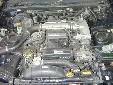

I think they may be the same. Here is a pic of my engine, check it out compared to yours, and you can work out if the hose is the same.

Looks similar to mine!

just take yours off, go to repco (or similar) and ask for a cressida top radiator hose from a 7MGE. When they bring it out, check it against yours, and if they are the same, then hey, buy it !! That is probably a good way to do it.
I am currently searching the net for a pic of a 7MGE in an aussie delivered cressida to see if it is the same as yours and mine. I will get back to you if i find one.

I'm pretty sure I've got one of these at home! Looks like Kristian's with the wrapping around it.

this is a pic of celicamad's cressida 7mge before he ripped it out to put the 1JZGTE in. The hose looks exactly the same as yours and mine. Repco should have one.

Here's a pic of a guy with a 7M-GE Cressida. I reckon it looks the same.
http://users.bigpond.com/cns_engineering/7M-GE.jpg

I just called Toyota back and he described the Cressida one to me, even describing the little heat sleeve that goes over it!
$11.60 for a brand new one haha
Thanks for all the help! it was interesting to see those pics anyway Smiley =

At least know we've all learned that the Soarer, Supra and Cressida all use the same top radiator hoses! yayyy
