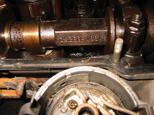

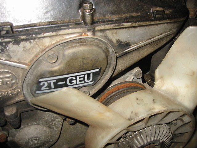

Just stiring the pot;
I was looking at my pics and came across some pics of the original 2TGEU's. You can see the difference between the older motor and the newer one with the common block.
Older:
http://www.geocities.com/hks7mgt/2TG.jpg
and newer ones:
http://www.geocities.com/hks7mgt/2TGEU.jpg
http://www.geocities.com/hks7mgt/2TGEU_2.jpg
And i just noticed there are even differences with the two newer motors. They are the oil cap on different sides, and the label on top is 'Toyota' on the first and 'Toyota DOHC'on the other. Also the last pic has a braket supporting the efi manifold and the fittings on the rocker cover to hold the bracket. I'm pretty sure the last pic is one of the last motors made.

icon10.gif  Re: 3t crank into 2tg Mon, 12 May 2003 02:53 Go to previous messageGo to next message
7M-GTEMA71,
The 2TG series of engine had alot of minor changes as they got newer. I'll try get pics of the changing rocker covers and post em up.
The First 2TG (11111-88220) Had "Toyota" and "1600" on the rocker cover.
(pictured further down this thread)
The 11111-88222 Rocker cover did not have "1600" on it. It had its EGR valve mounted there so only had "Toyota" on the Left Hand Side.
The 88260 Head appears to have received two styles of Rocker cover. The 88222 Version and the one used for the 88261.
The 2TGEU 11111-88260 and 11111-88261 heads Had "Toyota DOHC" on them and the DOHC lettering had raised edges.
The later version can kind of be seen here:
http://www.toymods.org.au/~rod/Pornstar/4some.jpg
I'll try find a better pic !
The 2TGEU 88262 Rocker Cover had "Toyota DOHC" on it and the DOHC was not with raised edges.
(As shown below in Red !)
I'll try find some pics !
[Updated on: Mon, 12 May 2003 11:45]

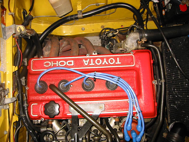

Here are some pics of how to identify the 11111-88262 Head.
Here's the rocker cover (They are not normally red !)
http://www.toymods.org.au/~rod/2TG%20Pics/88262%20Head/88262%20Rocker%20Cover.jpg
And here a link to a pic of the front of the head showing the GE2 Stamp and lack of head numbers.
http://www.toymods.org.au/~rod/2TG%20Pics/88262%20 Head/GE2%20on%20inspection%20panel,%20No%20numbers %20cast%20into%20head.jpg
And a Link to a pick of the cam number
http://www.toymods.org.au/~rod/2TG%20Pics/88262%20 Head/Cam%20number%20xxxxx-88262.jpg

7mgtema71
Re: 3t crank into 2tg Mon, 12 May 2003 04:19 Go to previous messageGo to next message
Well how do you descibe this? I have a head with no numbers on front, and was told it must be one of the last builds as they did that. But from what your saying, (DOHC edges are flat), well mine are the same as the toyota label (unless i'm missing your description of the different edges).
7mgtema71
Re: 3t crank into 2tg Mon, 12 May 2003 04:31 Go to previous messageGo to next message
Well the top of my motor is the same as the red top one you posted and the front is the same as that other link with the black rocker cover. So going on from what you said, there were two types of these numberless motors and one you mentioned was a TRD pre-production version. (Dumb terms now), when you say pre production, you mean pre 1971 or when ever the first 2tg was made and you are referring to the carby motor only right?
I love find out historical stuff!

icon10.gif  Re: 3t crank into 2tg Mon, 12 May 2003 04:37 Go to previous messageGo to next message
Yep the pre production TRD engine were Carby only and had this rocker cover (The 88220 rocker cover)
http://www.toymods.org.au/TA22/2T-G.jpg
If your has the rocker cover shown previously (the red one) and has no casting numbers if an incredibly safe bet to say it is an 88262 head. To tell for sure you can look at the cam numbers and/or look at the combustion chambers.
Don;t forget these engines are getting old so parts can be mixed and matched but there is not much likelyhood of anyone removing a casting number on the head !
Is the engine in your car or still out on its own ??
