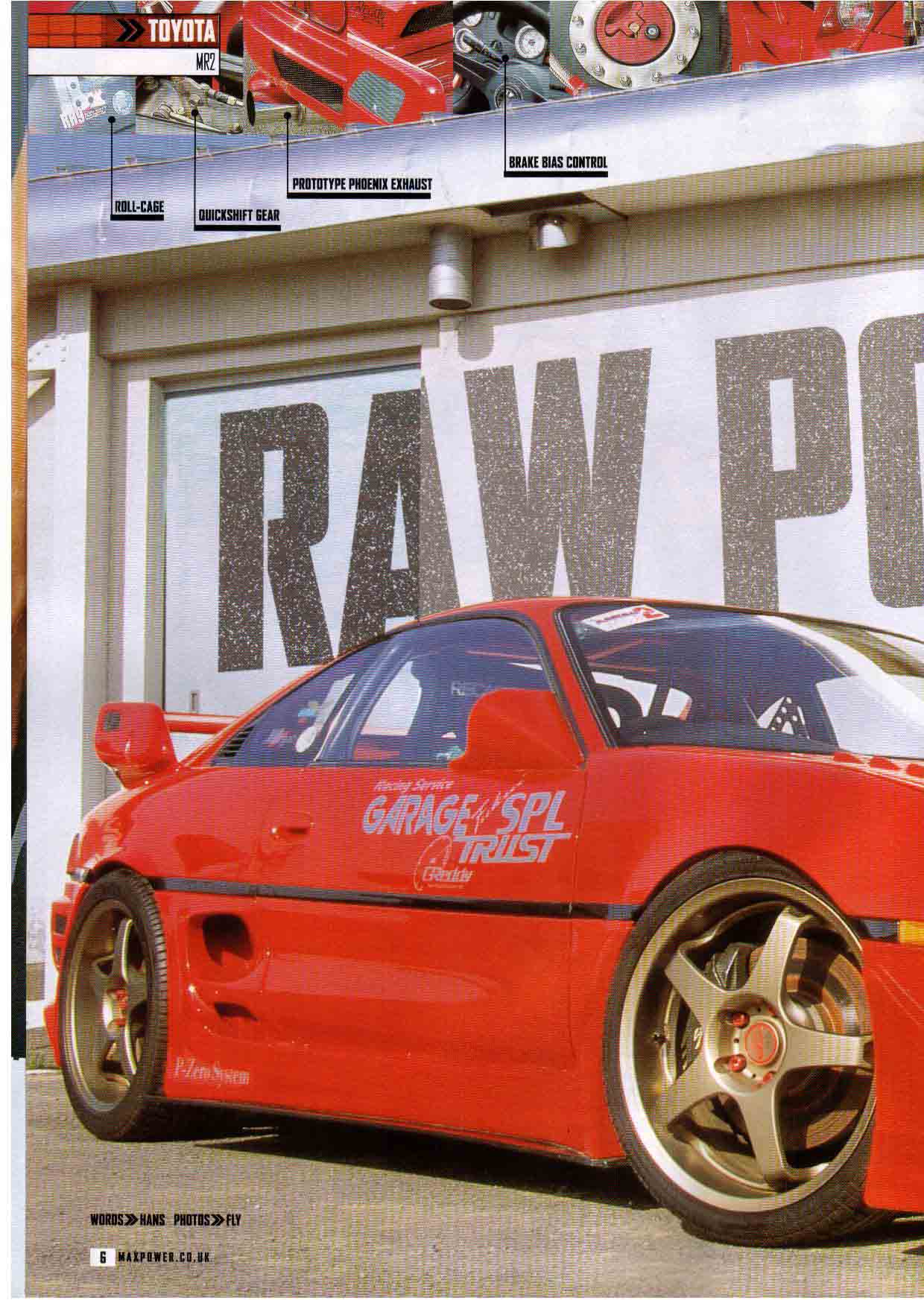

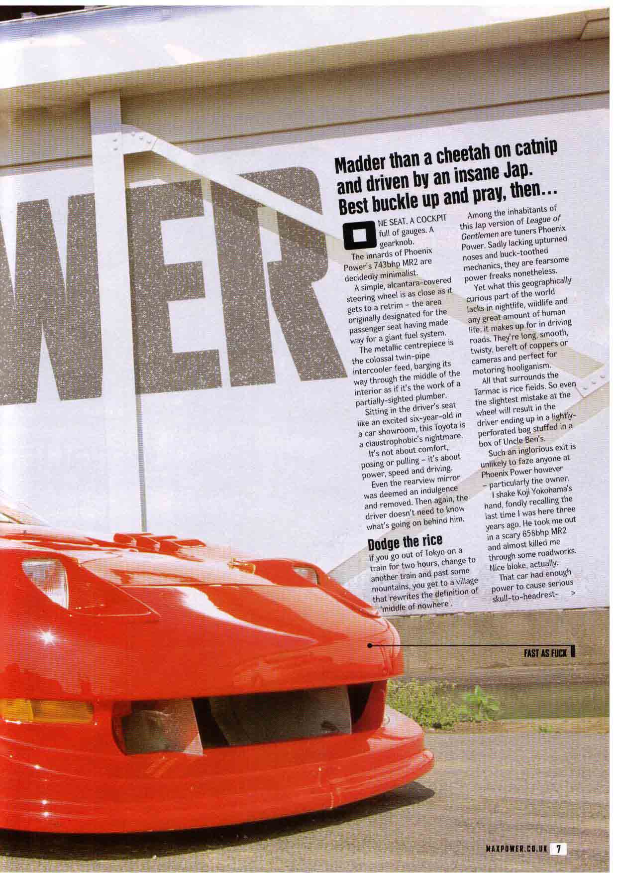

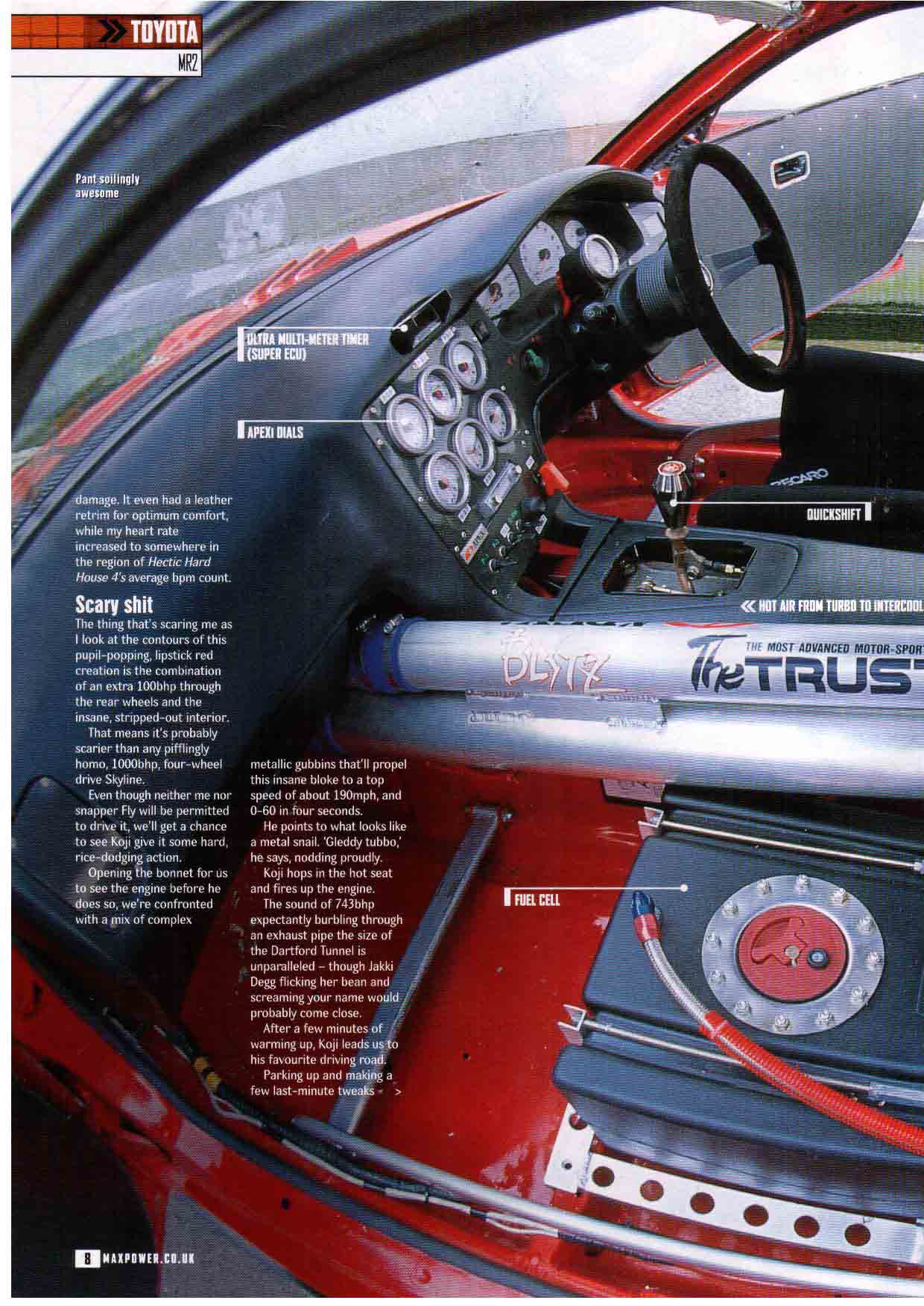

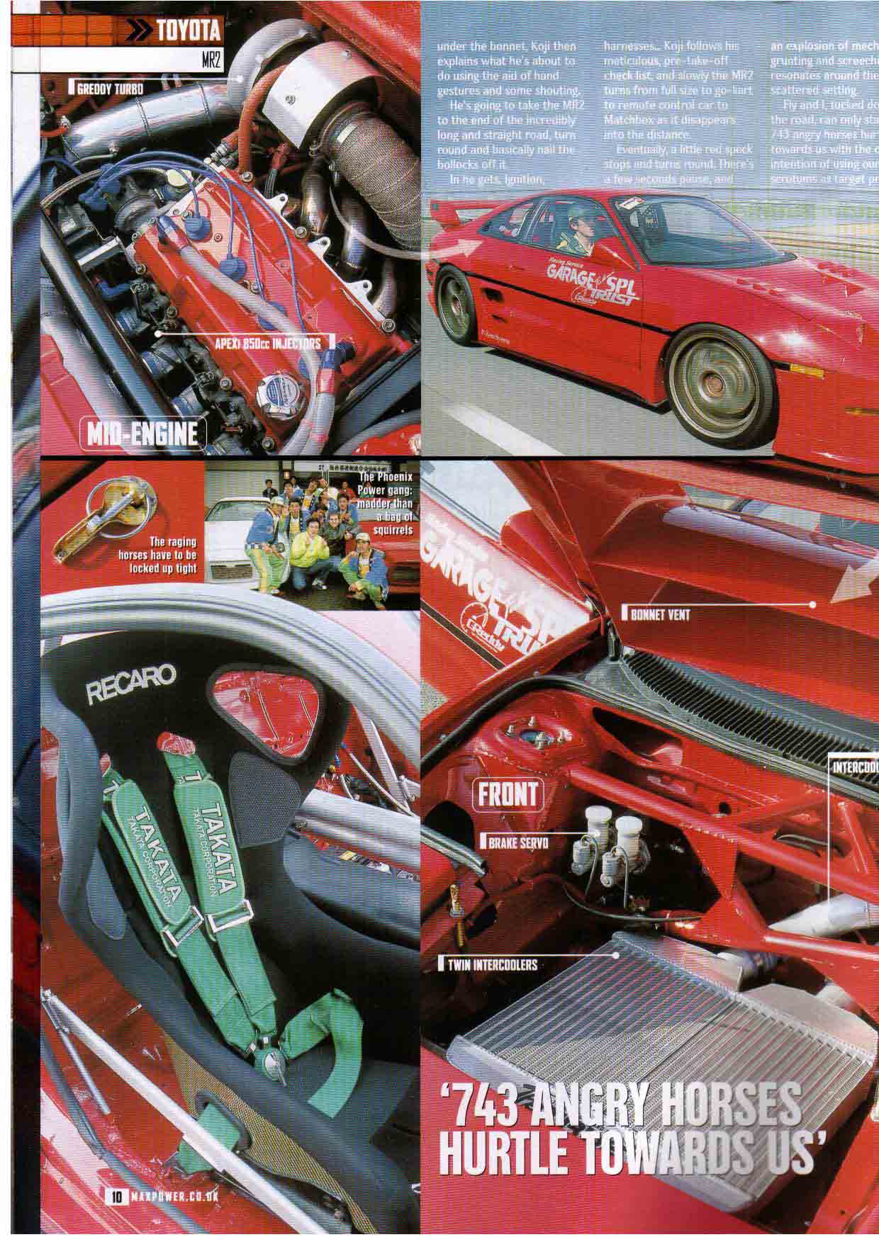

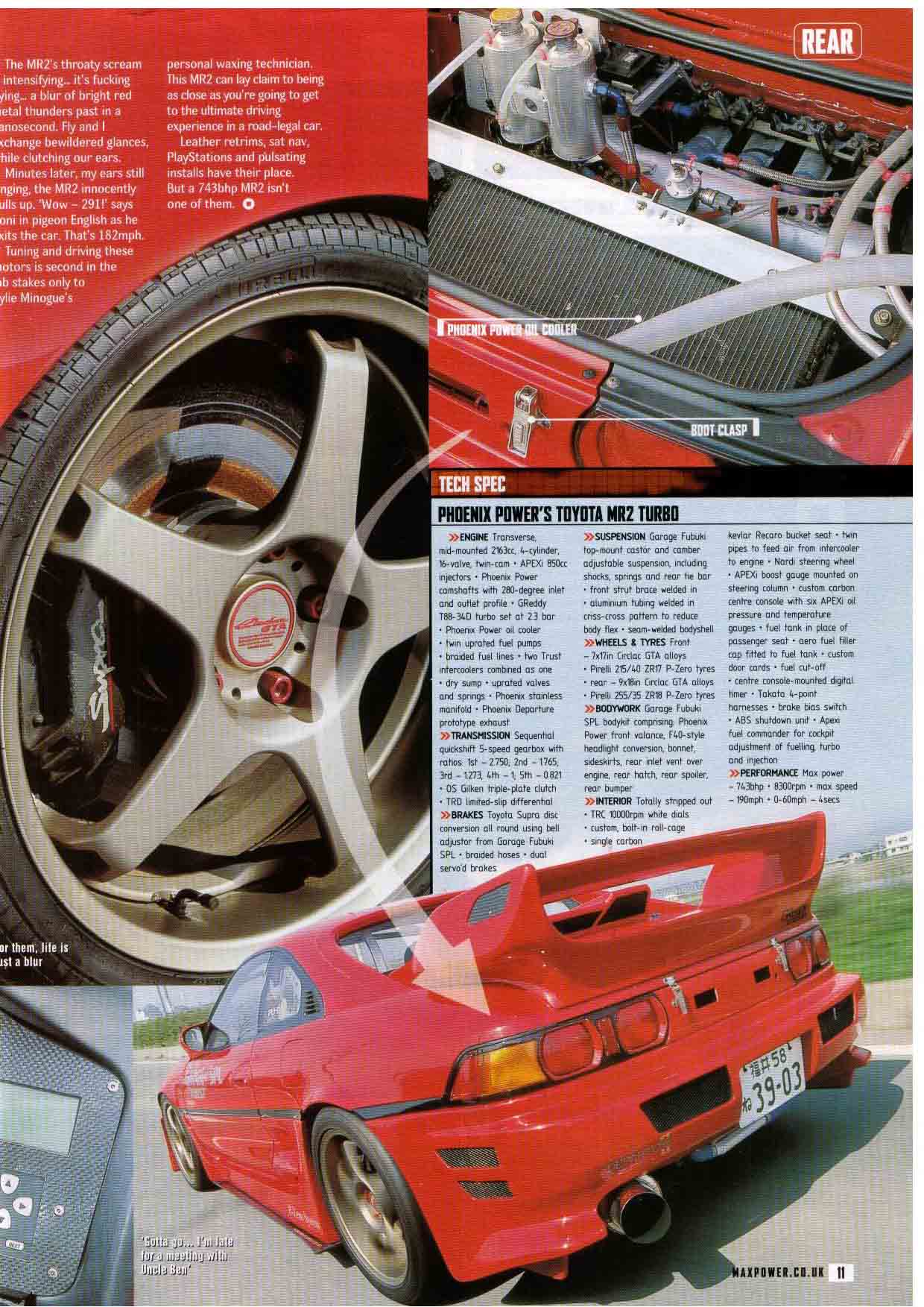

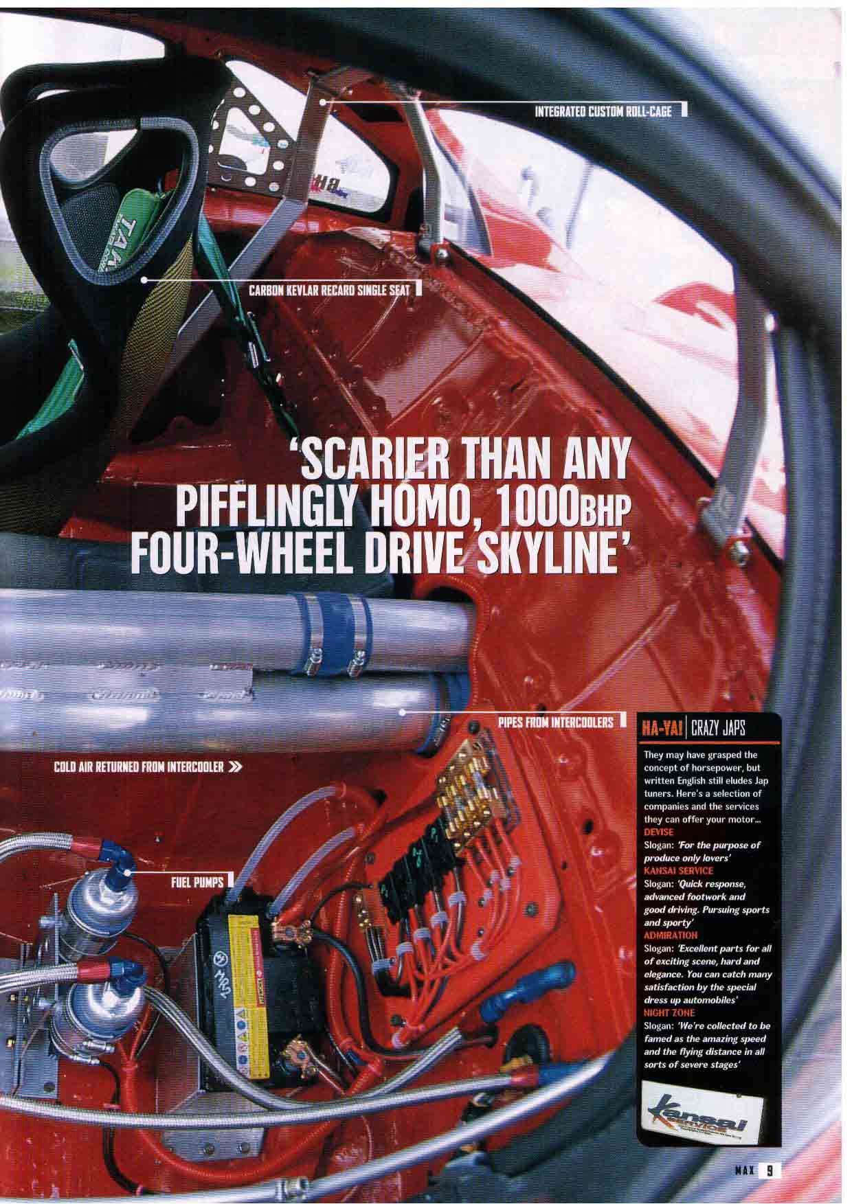

I hope these work!
http://toyotacover.50megs.com/images/mr2_1.jpg
http://toyotacover.50megs.com/images/mr2_2.jpg
http://toyotacover.50megs.com/images/mr2_3.jpg
http://toyotacover.50megs.com/images/mr2_4.jpg
http://toyotacover.50megs.com/images/mr2_5.jpg
http://toyotacover.50megs.com/images/mr2_6.jpg
[Updated on: Wed, 10 September 2003 20:04]
