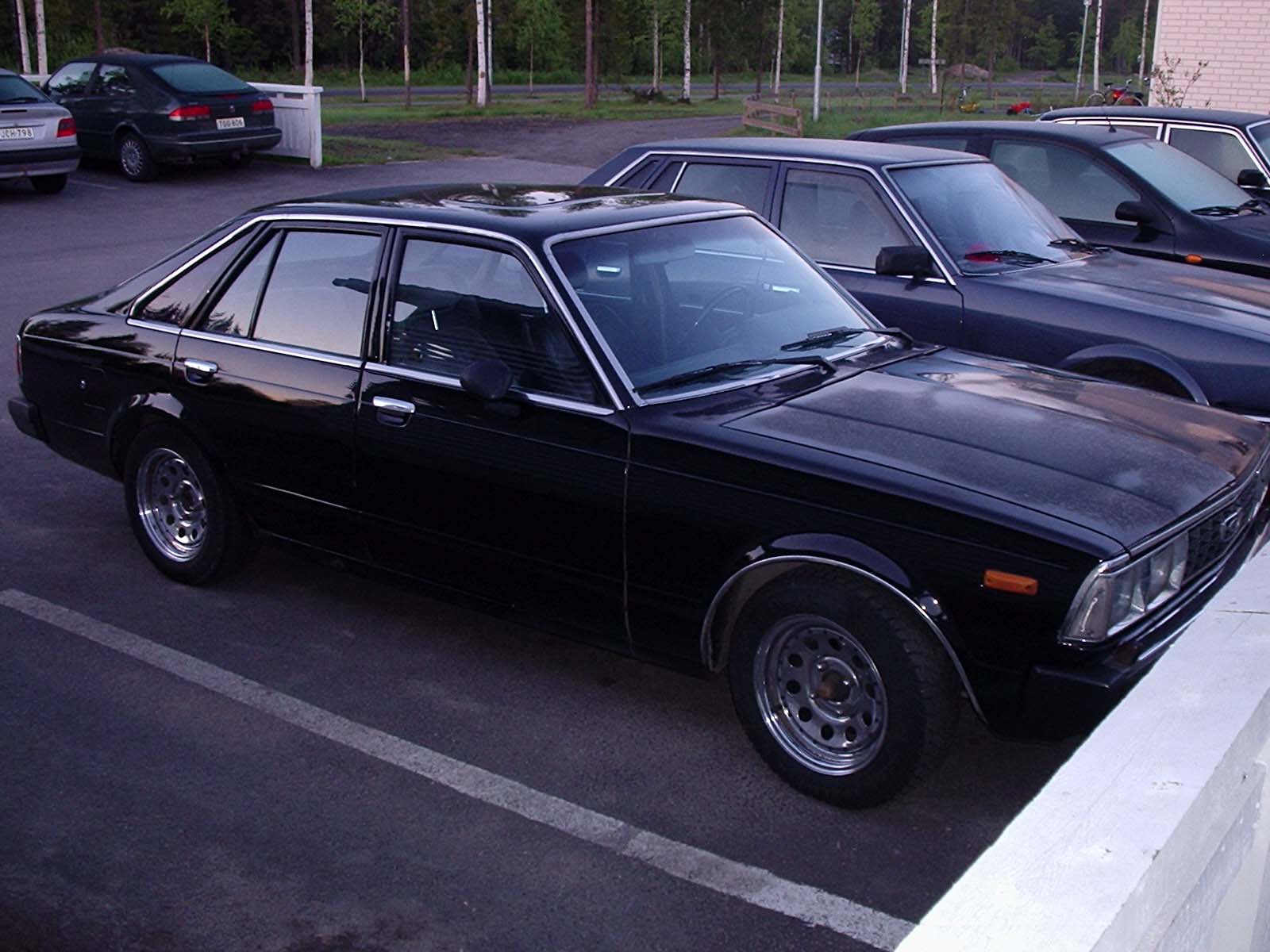

Jayem's Corona and MegaSquirt project. Tue, 16 September 2003 16:03 Go to next message
And my fully non-sik steel rims. Dont mind about them. I dont.
http://toyotacover.50megs.com/cgi-bin/i/images/hyv alaatu.jpg
Basic info:
Engine:
Stock 3T (not 3T-C)
Fully rebuild including stock carb.
Everything is new.
Stock CR 9.0 now 9.6.
Cast snots removed from head.
Martelius extractor and 2" pipe with one muffler.
Waiting for MegaSquirt with quad throttle bodies(under construction).
Turbo in a year.
Drive train:
Stock W50
Stock T292
Waiting for Hilux rear-end with LSD(under construction).
Brakes:
Stock front disks with Twin pot calibers.
Stock rear 9" drums.
Waiting for Hilux/pug disk swap. Im planning of using Saab 9000 calipers with suitable rotors at rear.
Chassis:
Short stroke coil-overs and Monroe sensatrac at front with 2.5kg/mm springs(too soft springs and shock not worth the money).
Rear (mega stiff) springs, unknown origin and Kayaba Gas a Just shocks(definitely worth money Smile ). Rear is wonderful.
Waiting for rear coil-overs(under construction). Maybe watts link and traction brackets.
Stiffer anti-roll bar for front and rear. New poly bushes all around.
Intrior:
Stock.
Exterior:
Stock apart from paint and mirrors.
Also door locks, badges, antennas, etc. removed.

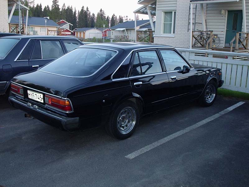

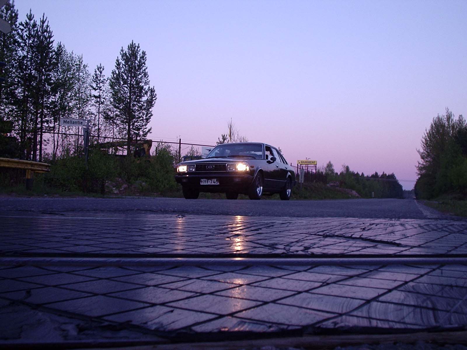

Re: Jayem's Corona and MegaSquirt project. Wed, 06 October 2004 10:41 Go to previous messageGo to next message
Here's some pics.
http://toyotacover.50megs.com/Jota1.jpg
http://toyotacover.50megs.com/Jota2.jpg
http://toyotacover.50megs.com/Jota3.jpg
Lots of things have happened after last post...
Quad throttle bodies are finished and I'm putting them in right now. I have also made and assembled Mega Jolt light junior distributorless ignition system and it's working. My EFI and turbo project is late because of crash I had. Plus I didn't have room for distributor any more and I didn't want to make compromises with my intake system. So I went to distributorless ignition system. It did took it's time. Anyway, anybody with T motor knows what I'm talking about Smile . Pics of throttle bodies are coming up...
