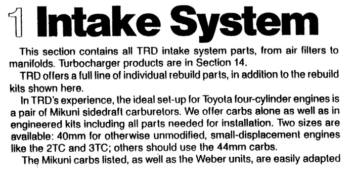

TRD actually recommend the Solex Mikuni Carb over ANY other side draft but hey I guess they wouldn't know !

icon6.gif  Re: 2TG reving prob Tue, 04 November 2003 11:41 Go to previous messageGo to next message
Here is a scan from the TRD catelogue !
http://www.toymods.org.au/~rod/Technical%20Info/TRD%20on%20Mikuni.jpg
Please note TRD sell BOTH webers and Mikuni's !
If it wasn't for peoples lack of ability and knowledge on how to actually tune a carby correctly, Mukini's wouldn't have such a bad name. Its really starting to shit me how poor quality workers blame the product rather than admit they don't know what they are doing Sad
