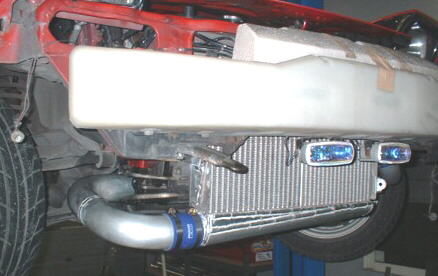

I have 1 series 5 rx7 intercooler sitting here, and can probably get another fairly cheap, and was wondering whether i'd suffer any considerable pressure drop in cutting off the end tank from one side of each, and having them welded together?
From what i've read, these cores are quite good (from an autospeed article) and I figure if the pressure drop is negligible, i'd end up with a decent sized cooler for < $100.

Run them in paralell and the pressure drop will be even less. Dont run them end to end.
If the tank design is good, it will work well

He means something akin to what Norbie did with two 2JZ intercoolers. Get new tanks made from them and run them in parallel:
http://www.norbie.net/Project2JZ/intercooler/medium_BigCooler02.jpg

Haha, but it was massif! How much did it cost to get the new tanks incedentally? It's working atm right, you fixed the leakin?
Norbie
Brisbane
Re: Cheapo intercooler idea Fri, 24 September 2004 00:59 Go to previous messageGo to next message
Yeah leaks are fixed now. I know a guy who runs a metal fabrication shop, he welded the extra supports on the cooler for $50 from memory. The original job cost me $280 plus the cost of the cores ($250 each).

How well does your parallel cores setup work Norbie? I've been thinking about grabbing two smaller cores from something...

Works extremely well... 305rwhp with stock turbos. I haven't got around to measuring pressure drop or inlet temps, but I'm seeing 18psi at the manifold and after a good flogging the intercooler outlet pipes are cool to the touch (inlet pipes are red hot), so that would suggest it's doing its job quite nicely.
In theory the pressure drop across the core should be half that of the stock JZA80 core (which is known to flow quite well), however if the cores had been joined in series the pressure drop would have been doubled. That's why joining two cores in parallel is the way to go.
