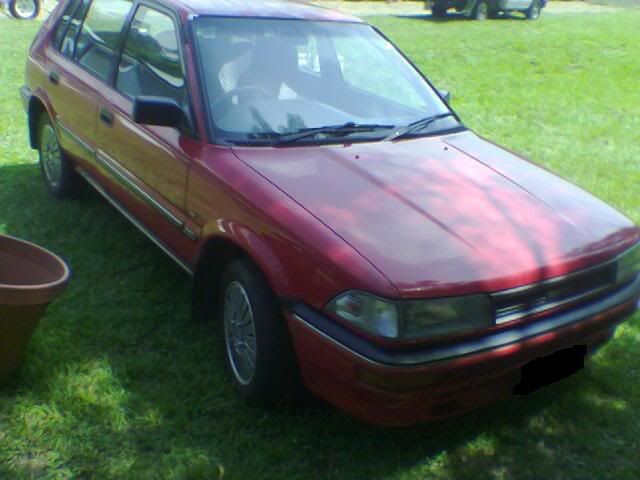

Re: Hey wats the main differenece to the 86kw and 100kw twin cam? Got pics of the car, take a look! Fri, 04 March 2005 05:28 Go to previous messageGo to next message
how the frig do u post attachments? ! its not letting me

http://img.photobucket.com/albums/v702/insalubrity _macca/Image048.jpg
http://img.photobucket.com/albums/v702/insalubrity _macca/Image049.jpg
http://img.photobucket.com/albums/v702/insalubrity _macca/Image050.jpg
http://img.photobucket.com/albums/v702/insalubrity _macca/Image051.jpg
http://img.photobucket.com/albums/v702/insalubrity _macca/Image052.jpg
Hey guys, it sux its only the piss weak 4ac. EFI version, but im gunna pick up a cheap 4age anywayz and i have someone lined up to help me rebuild, i have lots of plans for this though...lol!

Thats a 4A-FC

oh by the way, the paint on the roof isnt faded, thats just a protection agent thats worn off, it rubs straight off with a rag. Anywayz i wanted to know wat u guys reckon this car is worth. Imagine it all polished up and it has no rust, 160000km,perfect body and interior, straight panels, paint is very very good. Engine and equipment well kept and 12 mnths rego, seriously, wat would you guys pay 4 it?
